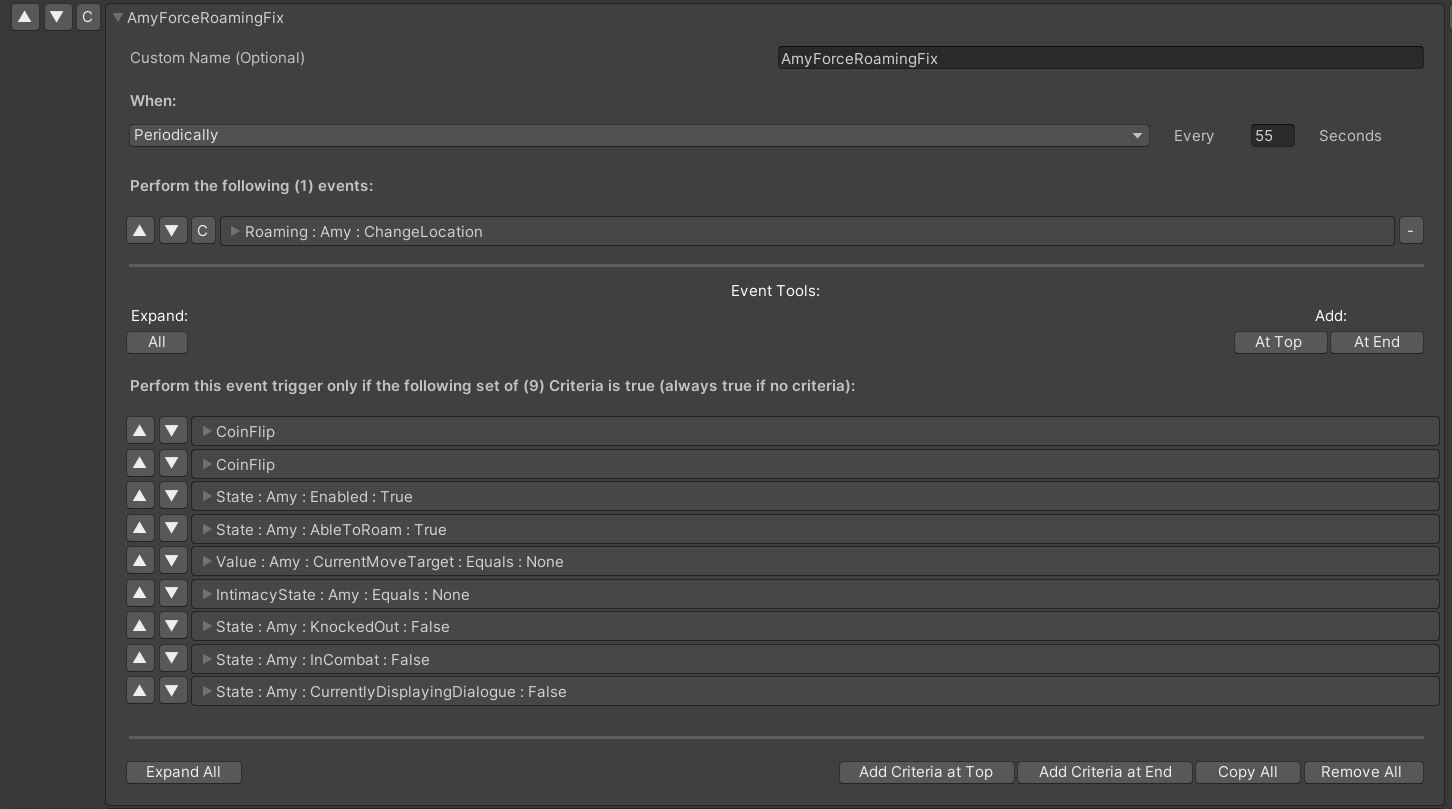

Here is what I did to emulate the 1.0.6/1.0.7 frequency of the roaming in my Gone Bad Party story.
First, I created a periodic triggers for each of the NPCs that normally roam (skipping Frank and Stephanie), like this:
In order to prevent this to trigger at the same time for all NPCs, I assigned different intervals between 55-65 for each NPCs.
This would give a 25% chance for it to happen, so on average 240s.
This is less than the original 1.0.6/1.0.7 roaming that was between 60-180s (so an average of 120s), but it should be known that in that case, the counter was only happening when NPCs were standing still, so actual old roaming frequency was took more time than this.
So 240s felt good enough for me, especially since 1.0.9 default roaming would still happen from time to time (but with 5-10 lower frequency).

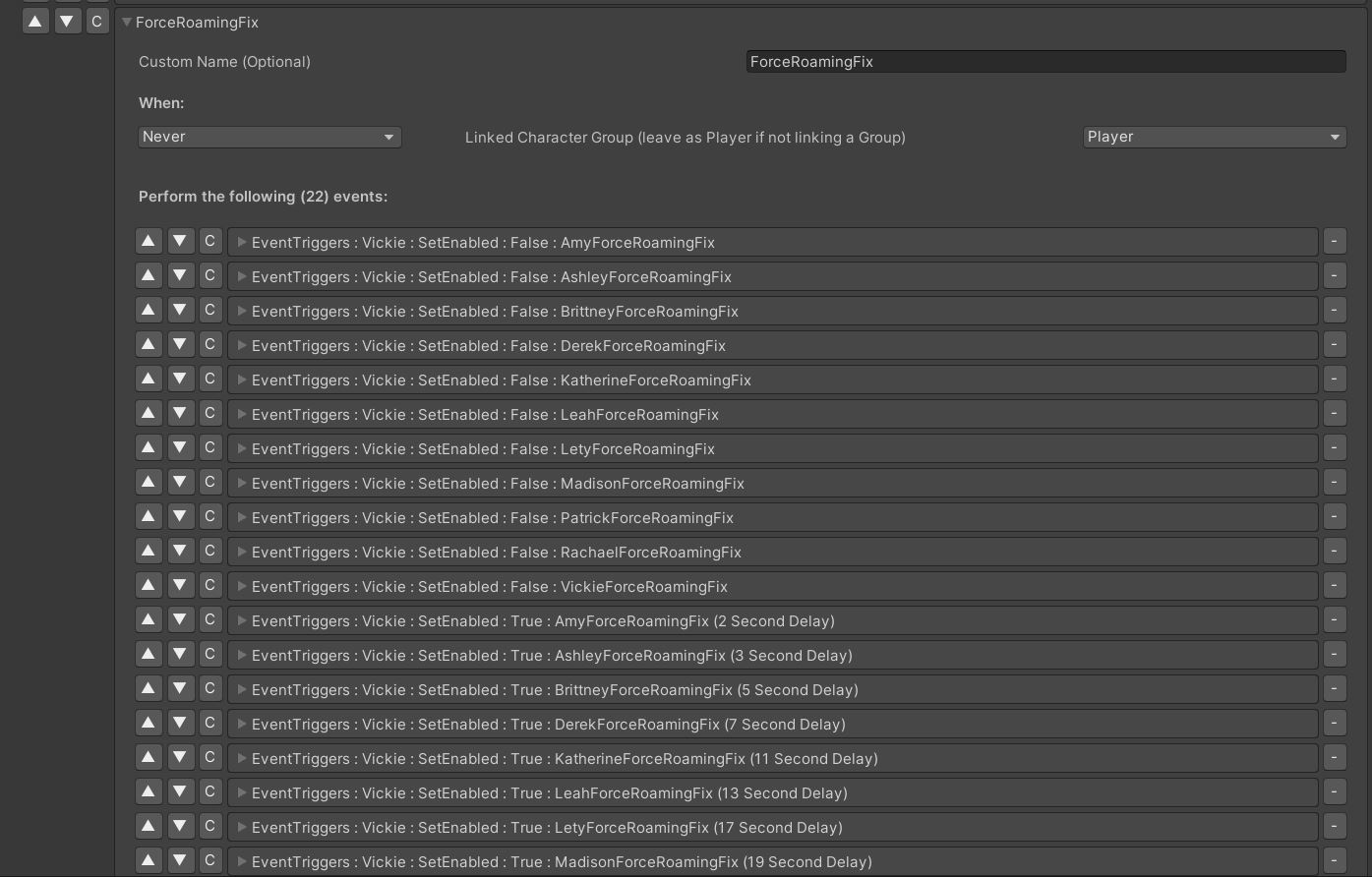

Then I did not want these triggers to start at the same time for each NPC, so I added a delay for the first start like this:
This would trigger once, on the first start of the story, where I disable all new roaming triggers for all NPCs, then enable them back with different delays for each (I actually used prime numbers in seconds).
This all together should give something close to organic roaming from the 1.0.6/1.0.7 version of the game without being too artificial.
It is not a perfect replacement, but a good bandaid until the game gets updated to include a fix to restore old roaming behavior.
