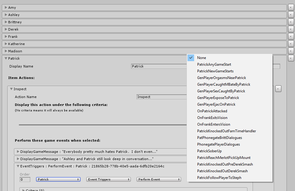

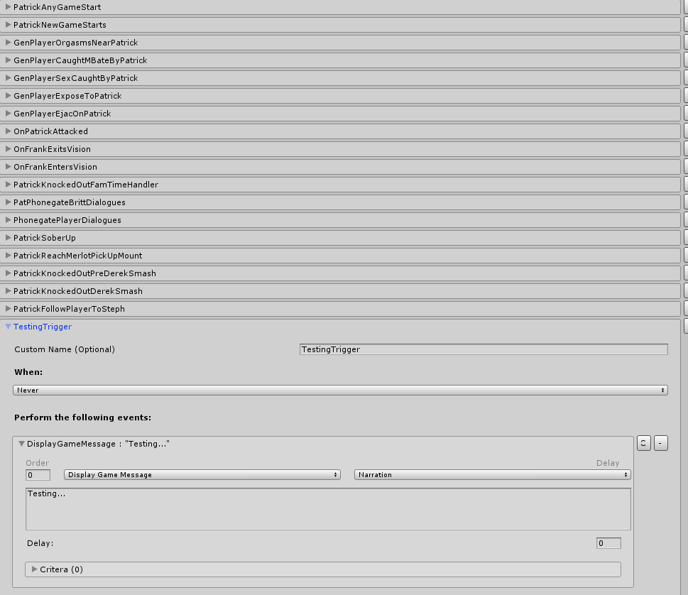

Using 0.12.4 and basically redoing the Original Story. I'm a noob at this and are just trying functions.
I've added an Event Trigger for Brittney, right now it only contains a DisplayGameMessage (When: never).
When I try to trigger it from elsewhere it doesn't show up in the list together with the events that came with the original story.
Am I'm missing something?
Event Triggers wont show as option

Attached 2 pics on how the Event Trigger looks and that it doesn't show in the list.
- Capture2.PNG (46.18 KiB) Viewed 15642 times
- Capture1.PNG (45.11 KiB) Viewed 15642 times

You shouldn't need to copy anything. Either in Unity, or in Windows File Explorer. The Import and Export functionality built into the CSC's Story objects are what you should be using. Import the Original Story right from the folder where it is stored, i.e. something like C:\Users\YOUR NAME\Documents\Eek\House Party\Mods\Stories\Original Story, and it will load in the CSC. Then, either export immediately to create your base "working copy", or start making changes immediately and export to a new folder whenever you're ready.

Forget it, its working now.
I re-downloaded CSC, created a simple event trigger and exported the Original Story again. Now it works.
I must've screwed the original files somehow.
