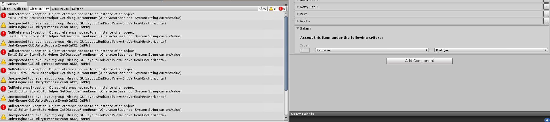

This was a problem in the previous version too. With a lot of items missing or incorrectly named. It is worse in this version though because now they're causing errors in the unity editor too like the attachment I've included. There's a lot of items this occurs for and using this version of the story creator is very difficult to say the least
unity error.PNG (90.58 KiB) Viewed 6069 times
