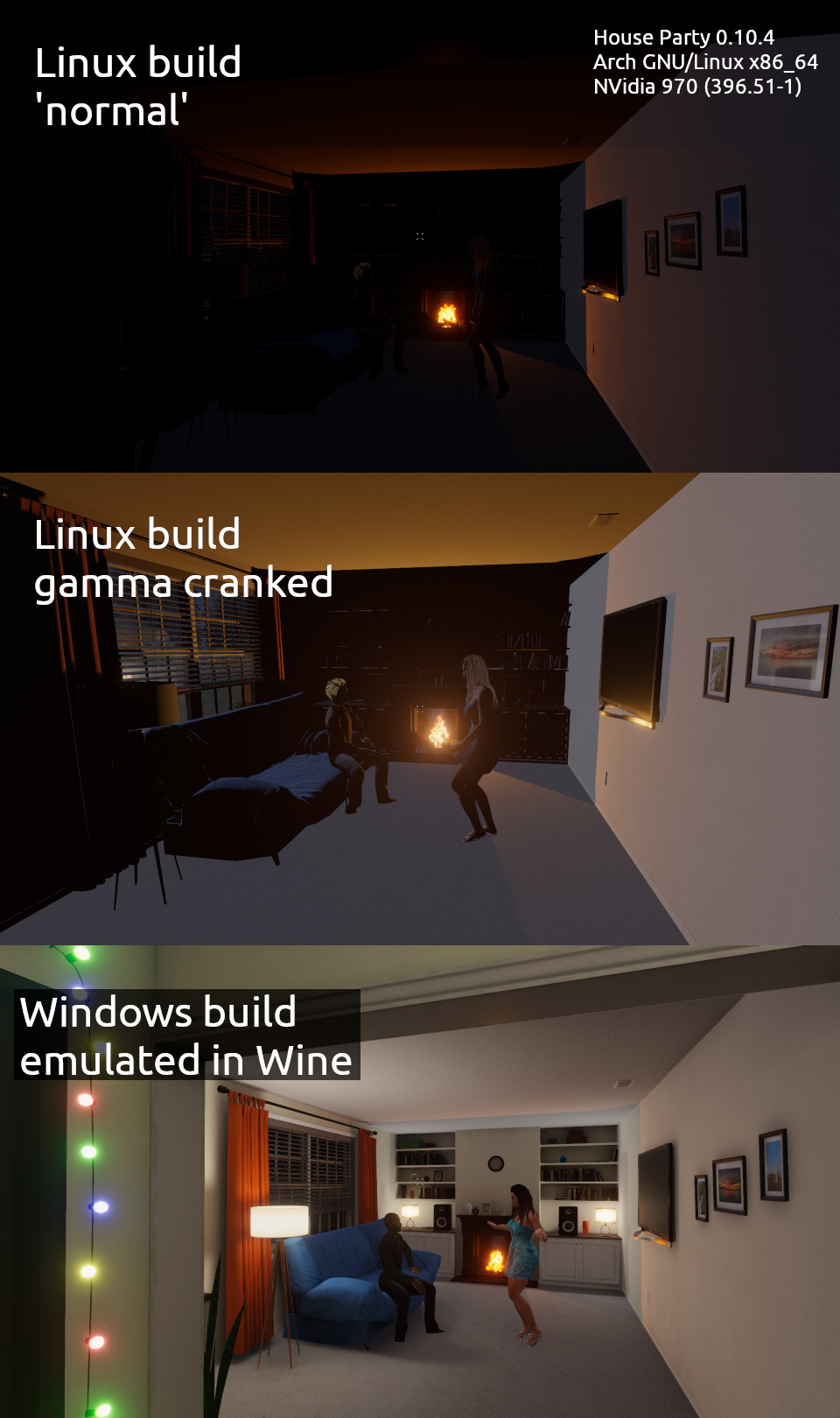

Second Issue: The linux build is way too dark. Here are a few screenshots to demonstrate:
Collage of screenshots
It's fairy self-explanatory I think. No idea what's going on really, other than there doesn't seem to be any ambient light and certain 'emitting' surfaces (TV screen, etc.) aren't working. This happens even when using the 32-bit linux build, without the bit of code that disables something or other to get it to launch. For the time being, I can still play the game using Wine, but it's not a great solution since the performance is noticeably worse. This wasn't a problem in 0.9.3.

Weird, it looks almost as if entire lighting/shadow settings just aren't taking effect...we'll look into it but unfortunately leave the entirety of the build process to Unity so it may be something we need to look into with our Unity support staff.
