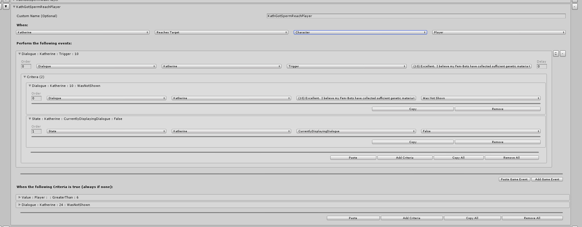

I am working on updating Katherine's Party using the latest release of the CSC. I have an event on Katherine previously programmed to trigger when Katherine:Reaches Target:Move Target:Player (see picture)
Since that looks like an error in the new CSC, I change it to trigger when Katherine:Reaches Target:Character:Player
However, after I make this change and export the story, Katherine is completely broken. She doesn't execute her game start events and cannot be interacted with in the game. The debug log suggests her story is not being exported correctly. See attached, but the key errors seem to be:

That one isn't really a bug, more like a...premature addition of 0.16 mechanics. Kind of like the Criteria Groups, Warp Over Time, etc. If you leave the event alone entirely you should be fine. If you need to make a new ReachTarget event trigger, start off by selecting a Character, then swap the Option/type over to MoveTarget. That error in the CSC exists now to alert users of a data mismatch in case they make a mistake, but the presence of the error itself shouldn't affect the story once exported. Let me know if this workaround does *not* work.

Wait... but how then to add new Reach Target where the target is Player if it is missing in move target list and doesn't work in character list dropdown?!?
Re: [0.15.5]Export Issues
It does work in the character list dropdown. You can select Character -> Player, and then change the type to Move Target. This error purposefully leaves the data in place without changing it. It's more of a "HEY THERE COULD BE AN ISSUE HERE" notification than it is a real error; it's a data mismatch warning that says "hey you have this type selected, but the value in the current data is not of this type". This was the best way of accomplishing error prevention without introducing any risk of data being automatically erased without user action being taken.
