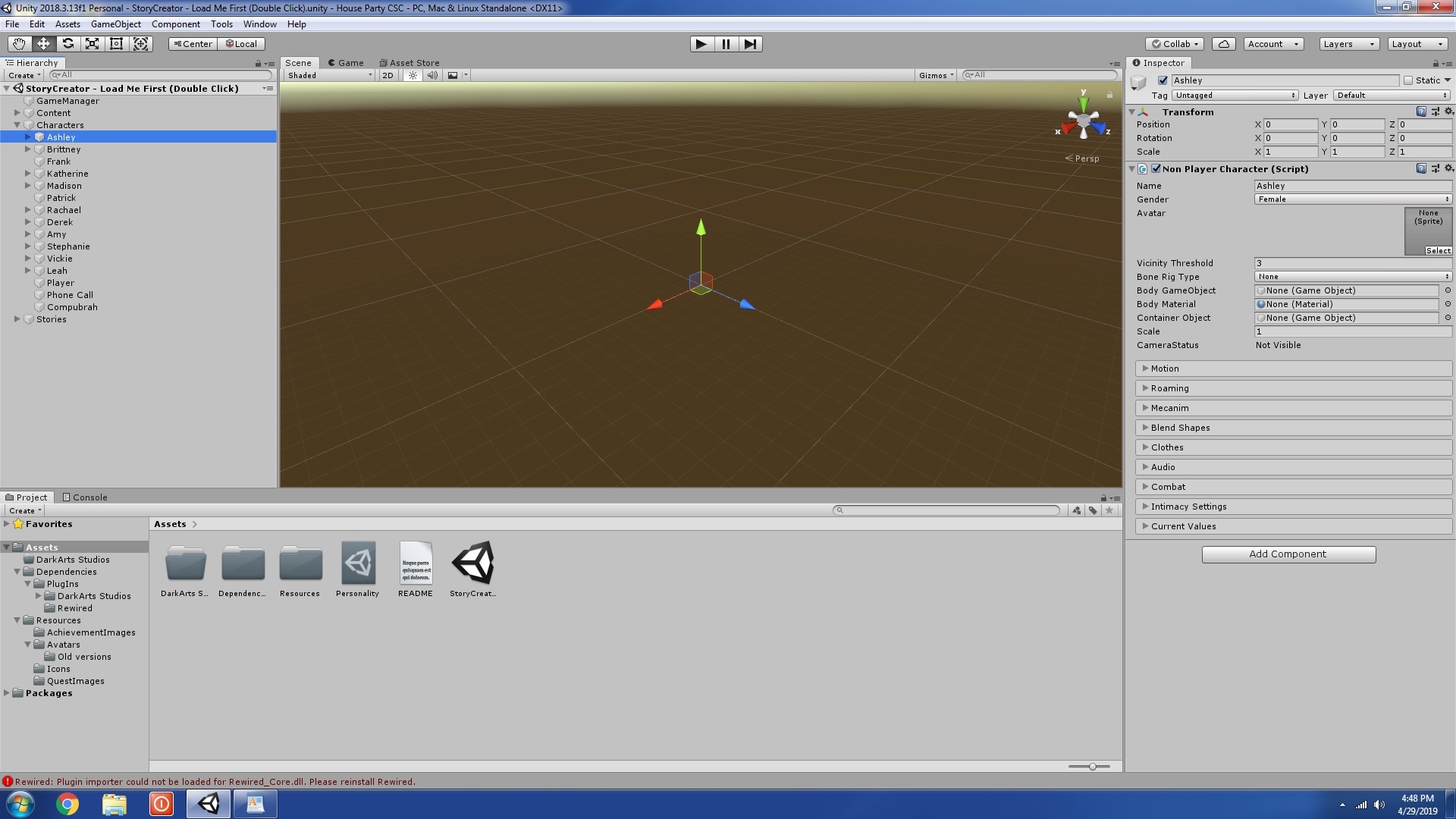

I did find the Unity 2018 3.13 and installed it but it insisted that I log into Unity ( probably because I had signed up before ) no biggie. I extracted the CSC files into a folder on the HD and loaded Unity. It did not see any files however on trying to open the CSC, I did associate the .unity file to Unity and opened it with open with. That seemed to work on reopening Unity alsy as the CSC showed up on the start up.
I did get the previous version on the other computer to load and open, and select a character there were a lot more options in that ver 12.4 to mess with than I am seeing here on 13.3 IE: Personality. and event triggers like on game start walk to for a particular character. That I think I was able to do before but it didn't seem to want to save or export to a name.story file
All I wanted to do to get started and get a feel for the process is to have Amy and Rachael personality's set to natural or +25 exhibitionism as well as other traits changed slightly ( something easy to check ) and on game start/player in view/walkto "hottub" for the two, Then to check in game use command line to remove top to check reaction. Seemed simple to me I thought.
All of the options for a character in the new CSC are totally different and most or missing or hidden. I will try to get a screen shot of what I have, and see.
Re: Starting from Scratch (Again)
Don't touch those character objects.
All that you need is inside Stories section.
