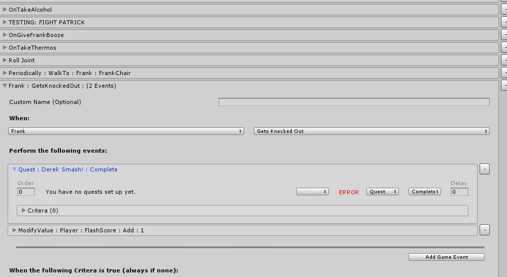

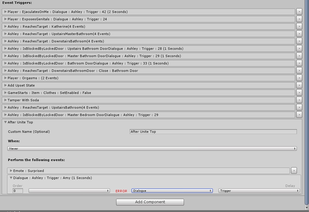

I am trying out some stuff in the Story Creator, but when i want to trigger an event after a dialogue, I can't select which event I want to trigger and it causes that I can't scroll any further down. Only until I change the trigger event to something like Pose or just anything else it makes that page scrollable again. Does anybody have a idea if it's a common problem or that it's just my pc that's doing this.
System Specs: i3-2100, ASUS GTX 1060 Turbo 6GB, 16GB RAM, Windows 10 Pro 64-bit
Custom Story Creator version: 0.6.0
House Party Version 0.8.7
Trigger event

The dialogue trigger is bugged. Same happens to me.
Unity 2017.3.1f1
Unity 2017.3.1f1
- BugCsC.jpg (175.29 KiB) Viewed 17371 times

Quests are also bugged. So basically this version os CSC is completely useless for creating any kind of new story.
- BugCsC2.jpg (92.79 KiB) Viewed 17310 times
