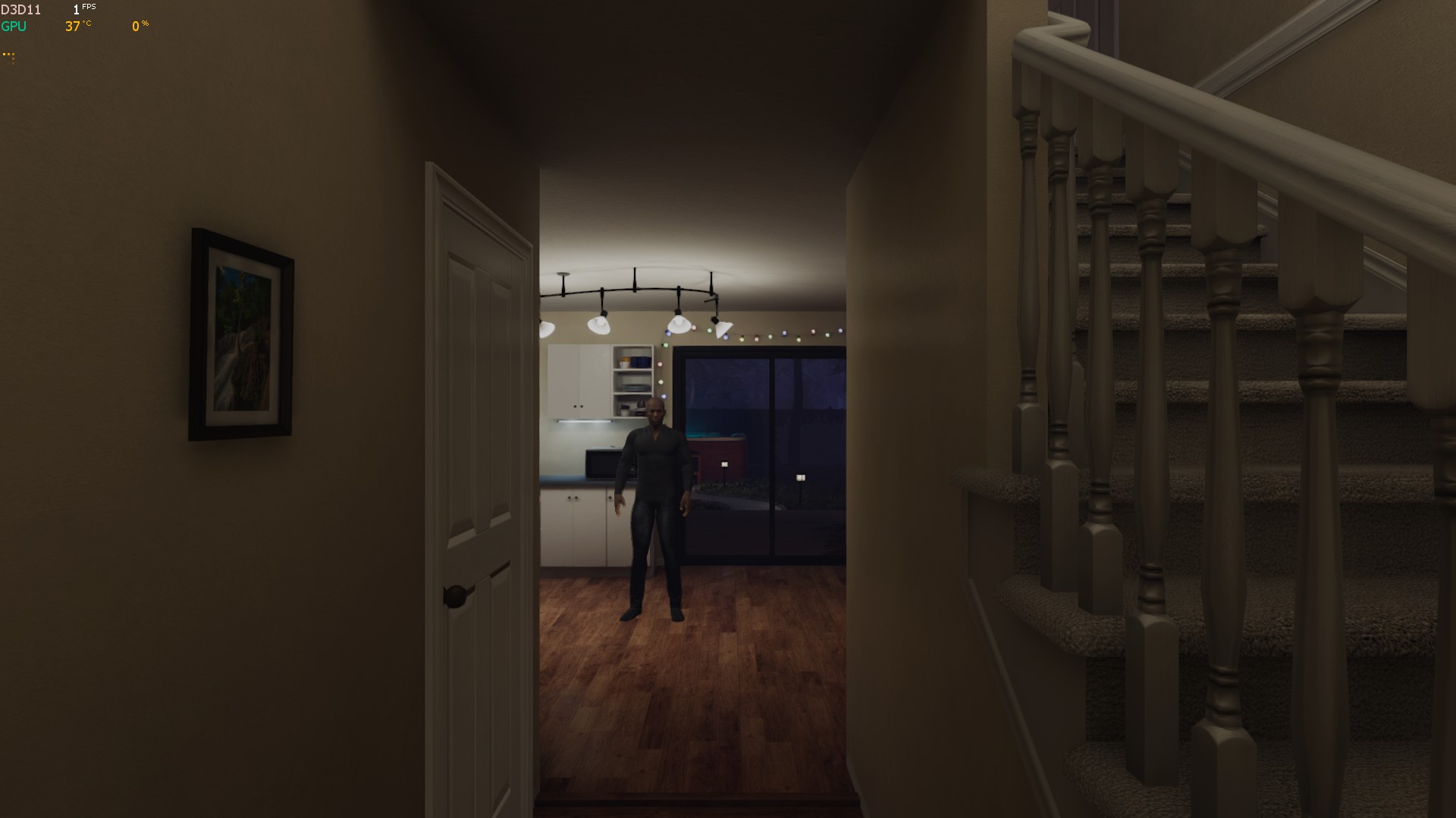

I use the RX480 and i5-6500, and I can play normally in the previous version.
But after I don't know which version is updated, I only have 1 FPS in the game, and the GPU usage is 0%.
Please Help.
My AMD Driver version is 19.7.3
House Party can't load with AMD Graphics Card
- 20190907233202_1.jpg (181.22 KiB) Viewed 11343 times

Re: House Party can't load with AMD Graphics Card
Hum. There is something stange. both your windows and GPU are directx12 compliant but for whatever reason, rivaTuner says you're back on directx11.
So let's try the fix for legacy amd gpu (even if your is clearly not legacy): https://forum.eekllc.com/viewtopic.php?f=7&t=712
Try with the "-force-feature-level-11-0" option
Have you try to use the embedded amd profiler while in game (ctrl+shift+o to open amd overlay if i recall correctly - fps might not be displayed, it's a know issue, but at least, you can also monitor the gpu usage). parameters of that windows can be set in Amd overlay (alt+r > performances).
Just to be sure, your computer is not a laptop (with embedded + extrenal gpu) ?
I tried various startup parameters before returning this question.
https://docs.unity3d.com/Manual/Command ... ments.html
I live in Taiwan, so the system language is Traditional Chinese and the time zone is Asia/Taipei.
Attached file for system related information.
