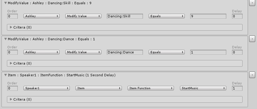

This was the solution I came up with, which is based on the info the game devs used to get Stephanie to start dancing to begin with. I haven't messed around with the console yet, so I'm not sure what the different values for Dancing:Skill do, but I assume they do different moves based on it. Dancing:Dance seems to be a binary value, 1 being dance and 0 being not. I just tuck those two values under an event criteria for hearing music and away she goes.

This is based on Creator version 0.7.0 btw
Re: Getting characters to start dancing
You do not need Dancing:Dance.
Dancing:Skill, if not specified, defaults to 3, and correspond to amount of different animations available. Valid values are 1-9 (anything above gives no difference).
All characters start with 3, Stephanie with 6, and she can have it raised to 9 after giving whippit.
Starting music with speakers is of course required, since speakers emit music that is prerequisite for dancing.
