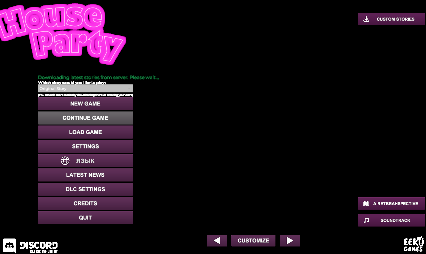

The game screen is black, with only sound and no characters.
When I open the game, the screen is black. Although the game interface exists, the background is all black. When reading save files or starting a new game, the screen is also black and prompts will pop up, but it's useless... there is no screen.
屏幕截图 2025-04-13 173117.png (163.45 KiB) Viewed 58412 times

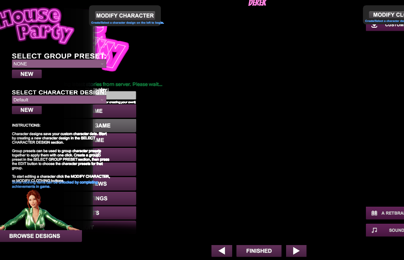

The character customization menu also has an issue of incomplete display
屏幕截图 2025-04-13 173222.png (242.19 KiB) Viewed 58410 times
