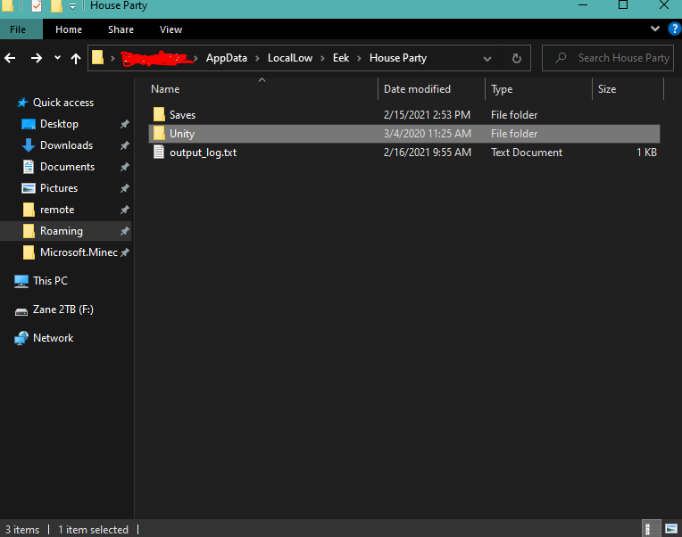

Folder C:\Users\***\AppData\LocalLow\Eek\House Party\ exists, but there is no crashes folder inside ?
Note that "C:\Users\***\AppData" is hidden, and may not be displayed in the explorer.
As a workaroud, type :
%appdata%
in the (sort of) url bar. This will take you to C:\Users\***\AppData\Roaming. Go up one folder, the down to LocalLow or Local, depending of the folder you're seeking for.

Re: Game crashes computer
It does exist and there is no crashes folder
but "C:\Users\YOUR USERNAME HERE\AppData\Local\Temp\Eek\" does not exist
